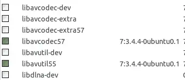

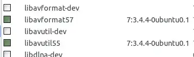

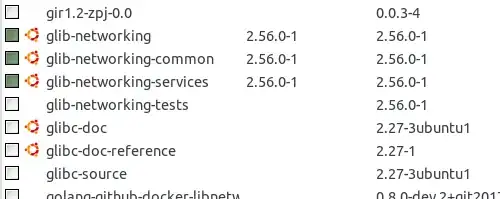

So I searched for those libs in synaptic, but in the screenshots below you can see that they all seem to be installed.
Does anybody know how I can solve this?

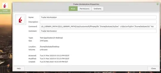

  15. Open properties window of your TWS shortcut(Desktop icon) and insert LD_LIBRARY_PATH definition before actual command. For example in my case:
    LD_LIBRARY_PATH=${LD_LIBRARY_PATH}:/opt/customsoft/ffmpeg/lib "/home/bobzier/Jts/tws" -J-DjtsConfigDir="/home/bobzier/Jts" %U
