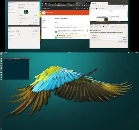

Screenshot 1 (built-in 200%, monitor 100%)
(Current) Best possible but the browser applications are all too big.
Screenshot 2 (built-in 300%, monitor 100%)
This shows the title text being based of the screen scaling and not the monitor scaling

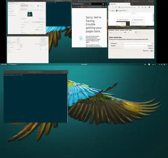

Screenshot 3 (built-in 100%, monitor 100%)
The applications on the monitor still look incorrect and now Gnome applications look tiny on the built-in display.

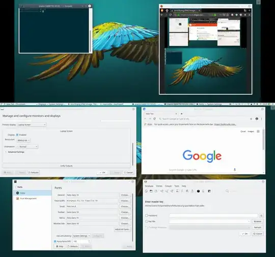

KDE Plasma
Then I tried KDE Plasma (recommended via reddit) and this for me works about perfectly - all windows are scaled consistently. The one issue is that by default just through the System Settings > Displays menu you can only scale both the monitor and the in-built screen to the same (same as Gnome X). This means that things are twice as big on the monitor as the desktop, but I can just put terminal windows on the monitor and scale the font down and that's fine.
The KDE Displays menu seems to be a fairly simple wrapper around xrandr - so hopefully they'll extend it to allow independent scaling through the menu. My objective when using Linux is that you can achieve things through menus so that others can use them too. However at least the scaling is consistent and so if I do use xrandr I should be able to get the perfect setup, where as on Gnome the windows were different sizes in the same screen.
Here is a comparison screenshot:

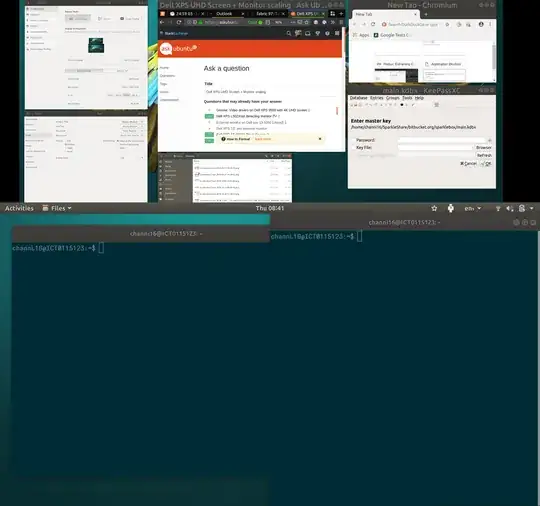

Update: switching to plain GNOME 3
After a couple of months with KDE a couple of annoyances popped up where it doesn't deal well with UHD screens and external monitors.
  1. KDE plasma has a very long loading screen ~10s which got more annoying with each day
  2. The screenshot tool would crash my system and I have to regularly take screenshots
  3. Moving windows between monitors became a problem
  4. There's no bold font in the terminal - silly annoyances but they build up
  5. Other constant niggles with windows
All of this was compared to the almost perfect experience that I have with Fedora + GNOME, plus I guess I'm just comfortable with using GNOME.
So as my current solution I have simply installed the base GNOME 3 (Wayland or not doesn't matter, but I do use Wayland) and I have accepted that the only scaling that handles all the things I care about is the default of scaling 200% on both the laptop and external monitor.
Even with plain GNOME scaling to 100% doesn't work - it just makes the text of the titles smaller rather than shrinking the size of the title bars.
I followed this It's FOSS guide for installing GNOME:
sudo apt install gnome-session
Then I needed a further tweak to switch the login screen back to gdm3:
sudo dpkg-reconfigure sddm
Now it's the case that actual regular Ubuntu GNOME 3 would also work fine, so it sounds like potentially my best option in the beginning was just to do nothing and accept the large titles on the external monitor **sigh**. But at least my desktop experience is fairly consistent now between my home Fedora Thinkpad laptop and my work Dell Ubuntu laptop.
But I do now have:
  1. Consistent scaling of fonts in the titles
  2. Consistent title bar sizes
  3. Putting my laptop to sleep and then re-awakening it whilst it's connected to an external monitor doesn't move the windows around
  4. Super crisp fonts in the terminal on both the external monitor and laptop (scaling the external monitor to anything other than 200% caused problems)
Now my desktop looks like this:

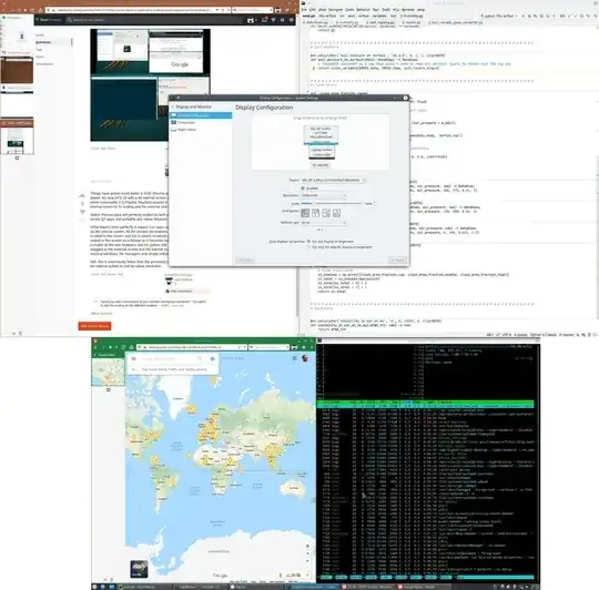

Things have gotten much better in KDE Plasma since the question was asked. My new XPS-15 with a 4K internal screen and an external 28" monitor works reasonably in a Plasma Wayland session in kubuntu 20.04 if I set the internal screen to 2x scaling and the external one to 1x.
Native Plasma apps are perfectly scaled on both screens. As far as I can tell, so are QT apps and probably any native Wayland apps.
What doesn't work perfectly is legacy X11 apps running through XWayland on the internal screen. All the window decorations are good and the content is caled to the correct size but is clearly rendered at a low resolution and then scaled to the screen as a bitmap so it becomes fuzzy. Unfortunately that includes all the web browsers and my python IDE. So they get mostly dragged to the external screen and the internal screen is used for (gorgeous) terminal windows, file managers and simple editors.
Still, this is enormously better than the previously accepted answer of setting the internal screen to half its native resolution.
External screen over internal screen
So my screen now looks like the above screen-shot. What it doesn't show is that the browser window in the bottom-left is a bit fuzzy compared to the super crisp terminal window in the bottom-right.
