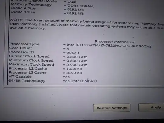

BIOS Problem?
In this answer, the "OS had probably no control over" the frequency and indeed, it seems none of the solutions work. My BIOS shows the frequency at minimum even before Ubuntu starts. Oh also, I'm dual-booted and Windows is really laggy too.
BTW, The BIOS also says my battery health is "Excellent", the charge is at 100% and the adapter is supplying 130W. I also updated my BIOS to the most recent version, 1.12.1 (following this).

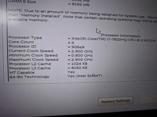

I found the solution finally from this Reddit post. It seems it is not Ubuntu as suspected but some bug in Dell BIOS where it permanently puts the computer in some kind of safe mode if you use a bad adapter. Using a good adapter won't turn off this safe mode thing on its own.
So, there 2 solutions proposed here (after you get a good adapter):
  1. open the computer up and disconnect the battery for 10-15s; or
  2. run the battery to empty
I took the second approach since I'm still waiting on my Torx screwdriver set to arrive. I ran the battery empty, then kept turning the computer on until the power button LED wouldn't come on anymore.
Doing sudo i7z (also tested sudo turbostat) show it's fixed: Real Current Freqency 3697.44 MHz.
My BIOS also now shows the CPU frequency not stuck at minimum:
BTW, I also switched back to intel_pstate and it's still working well, so had nothing to do with that after all.
