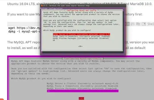

Before the second step I should have the prompt asking me which version I wish to configure with mysql 8-0 in the list. But I am getting only the version 5.7, as we can see in the picture below: enter image description here
If I go until the final step it will install the version 5.7.

In fact something that is not in the tutorial - we should accept mysql 5.7. In the next window, we will be asked to change to mysql 8.x See this video.

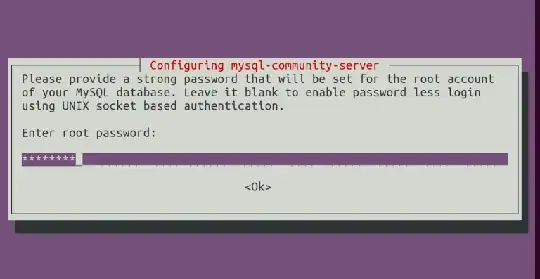

The latest version of MySQL will be installed on your system. During the installation, you should be prompted to create and confirm a MySQL root password.
img_1

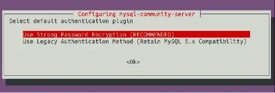

You can confirm whether you want to use the new password encryption feature... It is "recommended" to.
img_2
