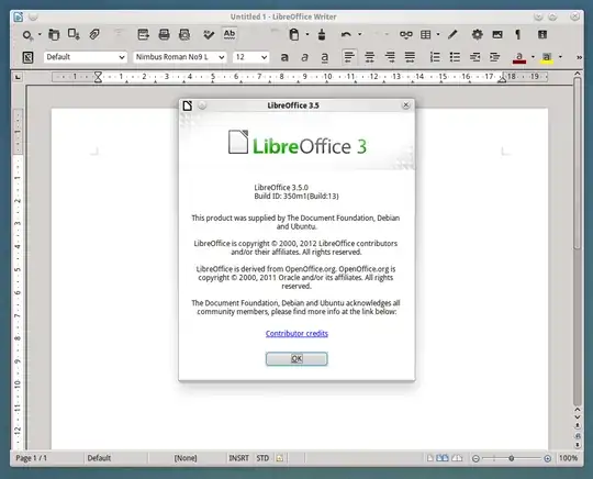

So after downloading this archive place it as /usr/share/libreoffice/share/config/images_crystal.zip and then setting view to crystal should show faenza icons again :)
screenshot

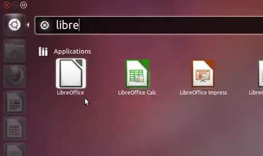

Start LibreOffice and open the appropriate settings Dialog:
start lo

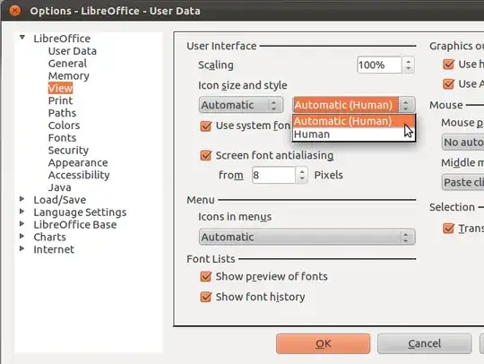

Choose the correct icon theme:
options
Does this help?
