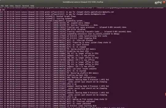

Here is the result of cat syslog during a wake event: syslog of laptop waking up
How do I put all this together to wake with keyboard input, but to suppress other wake events?

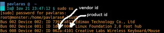

At your keyboard device id information the 4 first digits are the vendor id and the 4 next digits are the product id (see screenshot) enter image description here
Next do:
sudo nano /etc/udev/rules.d/10-wakeup.rules
Where "wakeup" enter your desired name of the script. Number 10 is the priority in case you have many other udev rules, the lower the number the 'rule' will be executed before the others.
Copy paste this and replace the vendor id and product id with your own wireless keyboard vendor id and product id.
ACTION=="add", SUBSYSTEM=="usb", ATTRS{idVendor}=="062a", ATTRS{idProduct}=="4101" RUN+="/bin/sh -c 'echo enabled > /sys/bus/usb/devices/usb8/power/wakeup'"
*usb8 for me is my wireless keyboard (you can also see that in the screenshot (Bus 008)), replace it with your own.
