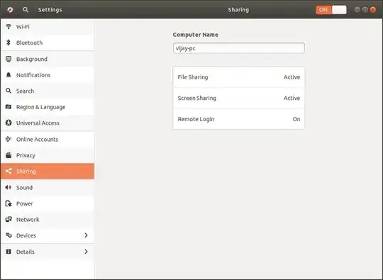

Default VNC server that comes with Ubuntu 18.04 Vino.
For setting up go to System Settings>Sharing
Default VNC client that comes with Ubuntu 18.04 is Remmina.
To turn of encryption run:
gsettings set org.gnome.Vino require-encryption false
