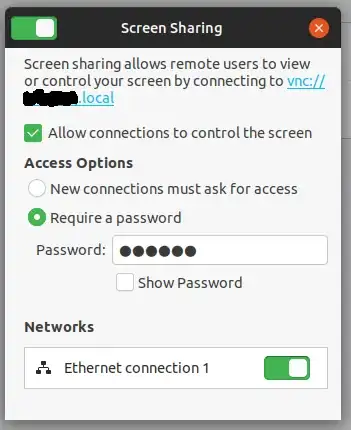

On the desktop machine, the Sharing settings are:
Sharing settings on desktop
Note: I can successfully use the remmina tool, using the VNC setting, to connect to the desktop machine and display it, without using the above gsettings setting on the desktop machine. But, when I use the TigerVNC type of vncviewer using this command:
