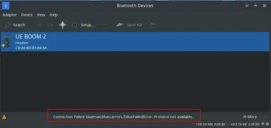

I use LXQT in Lubuntu 18.10 and I have a problem with keeping the Bluetooth-speaker connected to the laptop after logging out and in. It works fine after reboot though.
So, I have a solution that always works: rebooting - OR: reinstalling bluez:
sudo apt-get install --reinstall bluez
and that always works!
In any case, when my problem happens, the bluetooth is never blocked.
If I reboot or reinstall bluez there is no need to remove and add again the device, setting it to "Audio sink" is enough.
When this happens, after logging out and in:
  • The speaker is listed by blueman-manager, setting to 'Audio Sink' brings the error Protocol Not available.
In terminal:
~$ blueman-manager

fail (/usr/lib/python3/dist-packages/blueman/gui/manager/ManagerDeviceMenu.py:124)
fail org.freedesktop.DBus.Python.blueman.bluez.errors.DBusFailedError: blueman.bluez.errors.DBusFailedError: Protocol not available
/usr/lib/python3/dist-packages/blueman/gui/manager/ManagerProgressbar.py:165: Warning: Source ID 697 was not found when attempting to remove it
  GObject.source_remove(self.gsource)
and
~$ pactl load-module module-bluetooth-discover
Failure: Module initialization failed
because it was already loaded.
Removing the device and trying to add it again: it is not found at all!
Which aspect in the normal operation of bluez - one that is available at system startup as well as by reinstalling the package - could be lost by restarting the session? - And how to avoid that loss?
