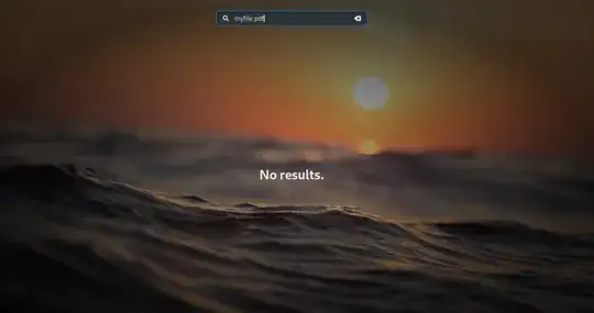

Tracker is now the default in Ubuntu 19.04, and I can successfully search for files and file contents in /home on an ext4 formatted drive. But I would also like to be able to search my ntfs drives. So how can I enable Tracker to search ntfs drives in the gnome search?
unable to find myfile.pdf located on NTFS drive

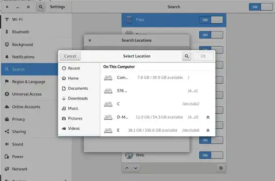

So far I have added my NTFS drive in Settings icon in the launcher -> Search -> Search Locations (gear icon)-> Other and, like recommended in Zeitgeist does not index folders in NTFS partition I also removed /media from PRUNEPATHS, executed sudo updatedb and rebooted - all to no avail.
Also, I believe that Tracker is continuously running in the background and making my laptop slow. Can I mitigate the performance loss by deactivating indexing of file contents somehow?
