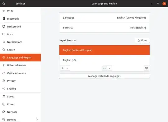

First, you need to take " Language and Region " under " Input Sources " choose " English ( India with Rupees ) " and bring it to the top as seen in the image below.

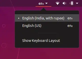

Now you will hope that when you type Alt Gr + 4 ₹ sign will appear. No, you will have to choose it from the top bar as well as seen below
