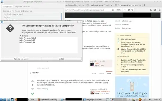

Reading this Q&A I clicked Preferences > Language Support and installed additional language packages as prompted, i.e. reinstalling the packages I'd just removed:
screenshot showing additional package installation prompt
But I don't have ibus like that other user, only fcitx and XIM. fcitx freezes lxpanel on either the first or second click. What should I do?
