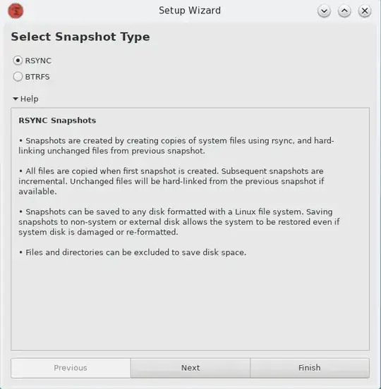

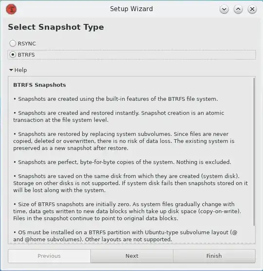

I see that there are differences between the two types of snapshots created by Timeshift as they are clearly listed once the program starts.
As my system is on an ext4 partition (and I find preferable to save the snapshot on an external drive), the option that I will use for now is RSYNC. But I am interested about BTRFS, which I plan to use in the future.

Benefits of using Timeshift (rsync) compared to cloning your disk:
  • Only first backup is a full backup, the following backups are incremental.
    • saves a lot of disk space
    • backing up is much faster
    • You can restore your system to any point in time you have backups for
  • Thimeshift will not backup unused space.
  • On restore, you can choose whether to restore the bootlader or not.
  • On restore, you can choose which files to keep and which files to restore.
Benefits of cloning your disk compared to Timeshift (rsync):
  • Doesn't need to be stored on a Linux File System.
  • Use standard Linux tool to restore.
Benefits of using Timeshift (BTRFS):
  • Backup happens on File System level using file system features only.
  • Initial backup is fast and doesn't use any space
  • Backup on the same disk, no additional disks needed
but ...
  • Needs BTRFS with special layout on the system
  • Backup on the same disk means data loss if disk is broken.
