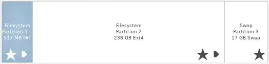

So, I'm thinking about my possibilities considering Dropbox is not supported on the encrypted ext4 filesystems anymore.
My first thought was, that I could create a new, unencrypted disk partition just for the Dropbox - is it possible to do it safely?
And if it is, then how?
My OS is Lubuntu 18.04 and my current disk looks like this, with my home folder being encrypted:

Since you have an ext4 filesystem already, you can just:
dropbox stop
sudo mkdir /my_dropbox_home
sudo chown -R $USER:$USER /my_dropbox_home
mv ~/Dropbox /my_dropbox_home/
Then run dropbox with that fake home folder:
HOME=/my_dropbox_home dropbox start
I got that trick from this answer.
If you didn't have an ext4 filesystem, then you could create a file with an ext4 partition inside it, and then mount that partition. I wrote a script to do that. Use at your own risk though!

You can resize/shrink your Partition2 and create a new partition using a linux live drive, but it is very unreasonable to do this.
Why not just adding a new folder under somewhere else outside your home in original rootfs and make sure the owner and group is correct?
