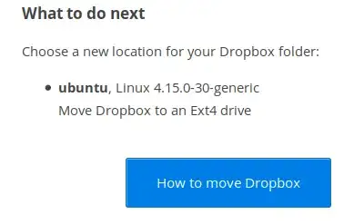

My Dropbox keeps telling me, that it needs to be moved to ext4 filesystem.

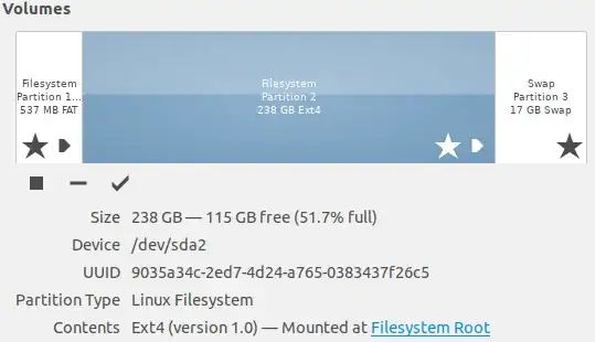

The problem is, that when I have a look at my disk, I see this:
It seems, that my filesystem already is ext4.

I'm using only encrypted home folder - could the problem be solved just by moving my Dropbox folder outside of it?

Dropbox doesn't support eCryptfs.
As per this official documentation
Note: ecryptfs is not supported, but Dropbox will continue to sync with supported file systems that are encrypted via full disk encryption (e.g. LUKS)
Also another important note
If you’re running a supported operating system, but you see a message that your computer is unsupported, you may be running Dropbox in an unsupported configuration.
