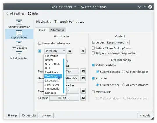

This basic method has a few possibilities itself which you can explore via System Settings > Window Management > Task Switcher. My preference is the very simple one shown below. On pressing Alt+Tab, I have a plain text display of open windows. Alt-tab
I keep the Alt key depressed and cycle through the choices with the Tab key. You can try various other options available on the Task Switcher page.
As shown in the image below, I've chosen "Text Only" from the dropdown and I have "Show selected window" unchecked. You may like something else.
Text only

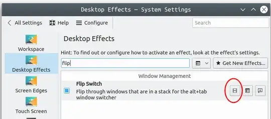

Open System Settings > Desktop Behavior > Desktop Effects and type flip in the search bar at the top of the page. Activate Flip Switch.
Flip Switch
If you click on the circled icon, you'll see a preview of what this can do. (It may take a while to load.)
If you decide you want to try it, open System Settings > Shortcuts > Global Shortcuts > System Settings and enter flip in the search bar (as before). Here, decide on a keyboard shortcut of choice to activate the Flip Switch or leave the existing choice in effect if there is one there. I've gone with Ctrl+MetaF10. Use Alt+Tab to cycle through the choices and press Enter when you've found the one you want. (Meta is the Super or Windows key.)

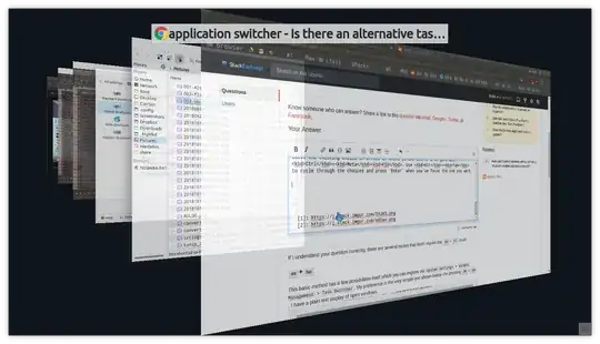

Flip switch in action

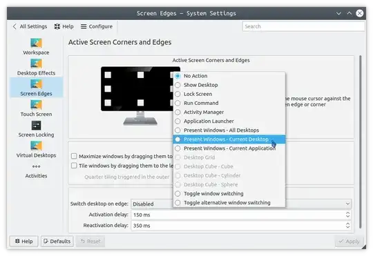

Using Screen Edges
Another thing for you to explore is System Settings > Desktop Behavior > Screen Edges. Again, I'll not go into detail but just leave you with an image which I took after right-clicking on the top-right corner white square:
Screen Edges
