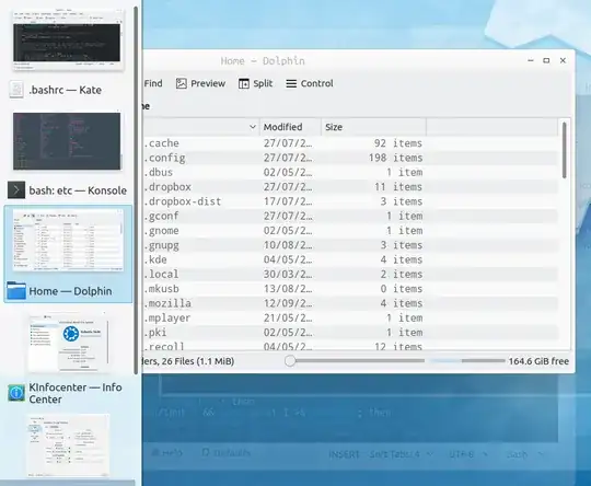

they are displayed on the left side of the screen,
I assume you're referring to something like this:
Previews on the left side of the screen

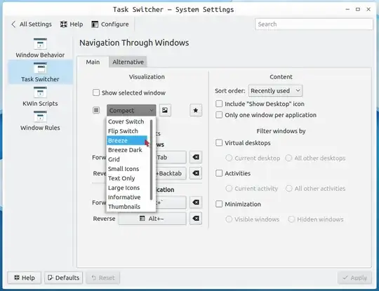

To change that, open System Settings > Window Management > Task Switcher
In there, there are just too many settings to describe in detail. The video link provided by mook765 goes into great detail.
For your purpose, avoid choosing Breeze or Breeze Dark in the image below.
Avoid Breeze or Breeze Dark
Whether you wish to have Show selected window checked or not is your preference.

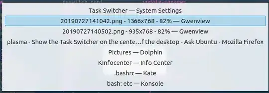

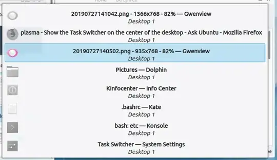

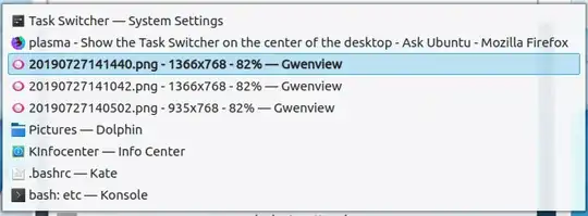

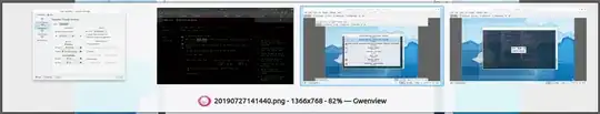

But here are images illustrating the task switcher in the center of the screen. (The images are cropped and don't show the full screen.)
Small icons
Small icons
Large icons
Large icons
Thumbnails
Thumbnails
