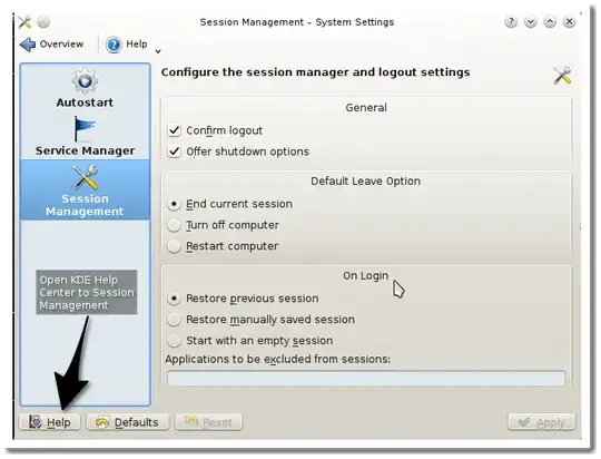

Regular Ubuntu doesn't restore the previous session but if this is an important feature you can switch to kubuntu. This answer has a sample screen I've recycled to display the setup:

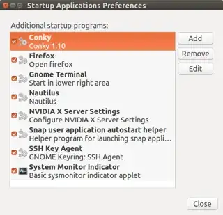

You can configure regular Ubuntu to automatically startup your favourite applications but they will not continue where they left off. There are a few exceptions such as web browsers which continue where they left of.
Use the Startup Applications app to define which applications automatically load when you sign on:
