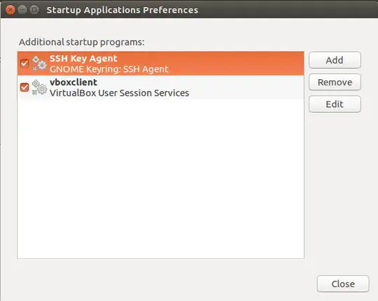

GNOME on Ubuntu 14.04 LTS, 16.04 LTS and 18.04 LTS does not have such options in Startup Applications (or gnome-session-properties) - see screenshot below:

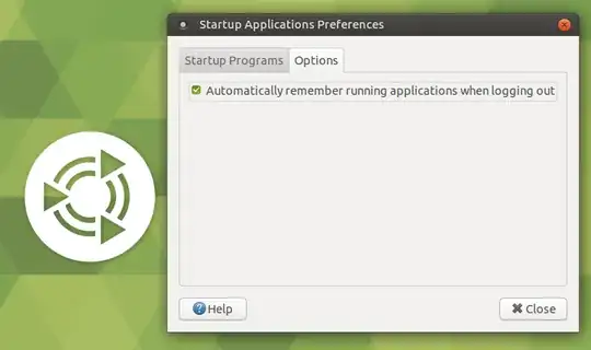

MATE
As far I know it exists in MATE Desktop Environment in any current Ubuntu version - 14.04 LTS (with MATE PPA), 16.04 LTS, 18.04 LTS.
You can access it from System->Preferences->Personal->Startup Applications (or mate-session-properties).
From my personal experience it restore several GTK-based applications such as Firefox, Pluma, Atril, Caja, Zotero on next boot.

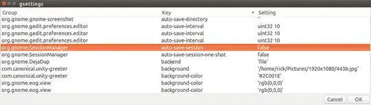

Using this tool I recently wrote: Bash one-liner to display ALL `gsettings` in Zenity or Yad. I sorted on Key and scrolled to the A section to find:
Note: Many people will prefer to install dconf-editor to navigate to the gsettings and set the values.
To manually find the states use:
$ gsettings get org.gnome.SessionManager auto-save-session
false
$ gsettings get org.gnome.SessionManager auto-save-session-one-shot
false
To save the session for across reboots use:
gsettings set org.gnome.SessionManager auto-save-session true
Then reboot.
Note: This doesn't work in Ubuntu 16.04 but does in Kubuntu.

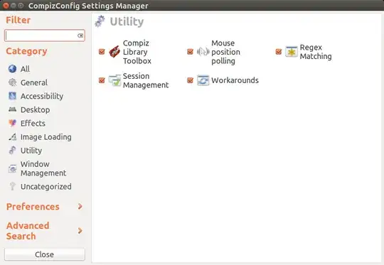

Someone recommended here to use Compiz Session Management:
but it doesn't appear to work in Ubuntu 16.04 either.
