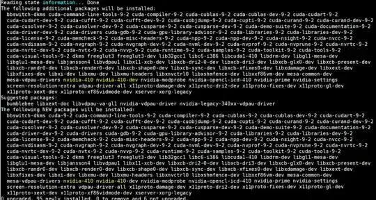

I'm trying the CUDA 9.2 and drivers 396 configuration but the drivers that sudo apt install cuda-9-2 installs are the 410. How can avoid that?

Unfortunately with the NVIDIA repo, it installs the newest driver that is in that repo. At the time I wrote the answer that was the newest one there, then they recently changed it. So, to do the older driver you will have to download and install the CUDA 9.2 manually.
