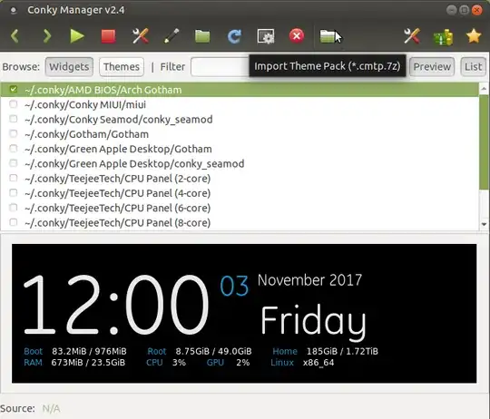

As far I can understand from Conky Manager's source code it can install special prepared theme pack files (they are named *.cmtp.7z).
You can install such themes by pressing the corresponding button "Import Theme Pack (*.cmtp.7z)" on Conky Manager panel:
Import Theme Pack (*.cmtp.7z) button location
So you need to download such file from somewhere. I have tested theme named Arch Gotham from OpenDesktop and it installs normally on my Ubuntu MATE 18.04 LTS (I do not have Budgie, desktop is not a problem in current case) with conky-all and conky-manager from our previous Q&A.
Other way to install is to download *.cmtp.7z file, then drag it and drop it to the Conky Manager window.

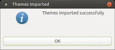

As the result you will get the window shown below
Themes imported successfully

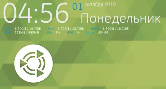

and theme/widget will be added to the list and may be shown on desktop (if enabled):
AMD BIOS - Arch Gotham is shown on desktop
