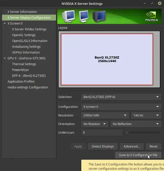

What do do if you can't find an /etc/X11/xorg.conf
Now, for those of you who, like me, did not have an /etc/X11/xorg.conf (most people running Ubuntu, for instance), you may be panicking thinking that you won't be able to apply this fix. Not to worry, I had the same issue, and I won't leave you hanging.
On my main machine, I’m running Linux Mint 18, but this should work with any distribution, I suspect. I did not have an xorg.conf, so what I did was launch the nvidia-settings tool and generated a new one by going to the X Server Display Configuration section and under file name enter /etc/X11/xorg.conf (uncheck merge with existing if it's checked as this is only useful in the instance of where you have one) and then click Save to X Configuration File.
This should generate one for you which you can then modify using the steps above.

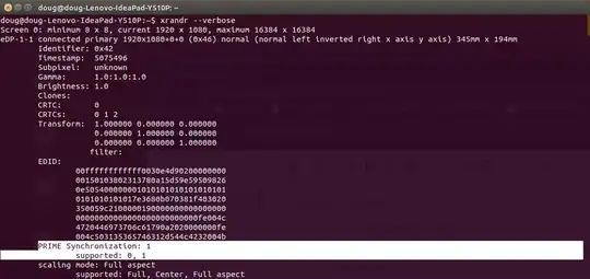

For NVIDIA Optimus you need to use prime sync.
  1. In a terminal create the /etc/modprobe.d/zz-nvidia-modeset.conf file:
    sudo nano /etc/modprobe.d/zz-nvidia-modeset.conf
  2. Insert this line:
    options nvidia_drm modeset=1
  3. Press Ctrl+O, Enter, Ctrl+X to save the file and exit.
  4. Run this command:
    sudo update-initramfs -u
  5. Reboot.
To check if everything works as expected after rebooting, run this:
xrandr --verbose
Scroll up and look at the top result area. You should see:
PRIME Synchronization: 1
        supported: 0, 1
See this example:
xrandr results
