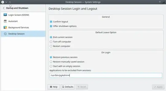

Facing the same issue on Ubuntu 18.04 with KDE Plasma 5.12.6. The key problem is that KDE saves desktop session and restores it on reboot. That's why pgAdmin 4 starts automatically if it was running before reboot.
In order to fix this go to "System Settings", select "Startup and Shutdown" tab in "Workspace" section and then select "Desktop session":
Desktop session
You will see that "Restore previous session" box is enabled in "On Login" section there. If you want to exclude pgAdmin 4 only from being restored on login then just type a full path to its executable in "Applications to be excluded from sessions":
/usr/bin/pgAdmin4
You can detect a path by running:
which pgAdmin4
If you don't want to save desktop session related data then another simple solution is to tick "Start with an empty session" box.
After that click "Apply" button and reboot the system. Now pgAdmin 4 will start and open a browser only when you make it explicitly.
