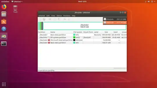

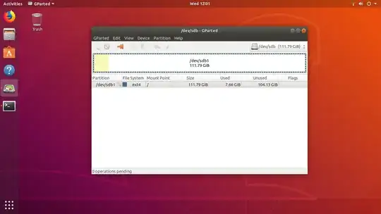

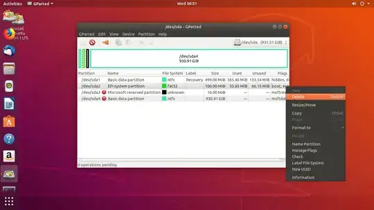

Here are my sda-1tb hdd and sdb-120gb ssd.

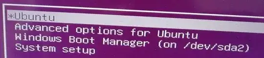

I have windows10 on sda and Ubuntu18.04.1 on sdb. Grub is on sda.
You can see windows10 is installed in device sda with EFI partition on sda2. This is what controlling the grub now.

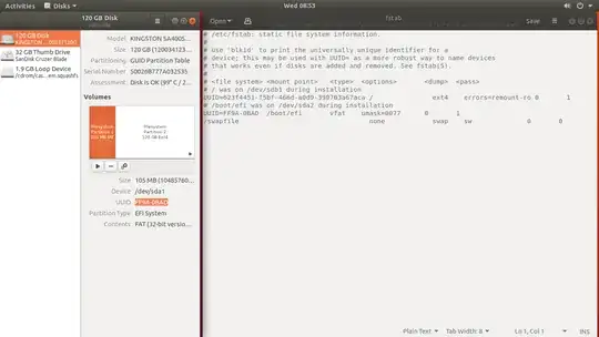

Important: this partition sda2 has UUID matched with the text in the file /etc/fstab on device sdb.

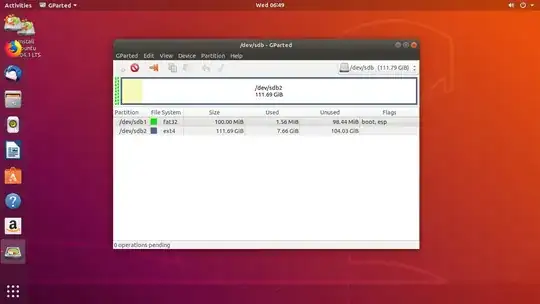

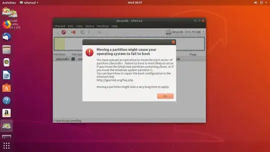

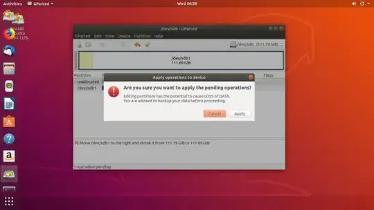

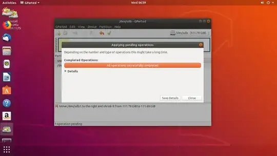

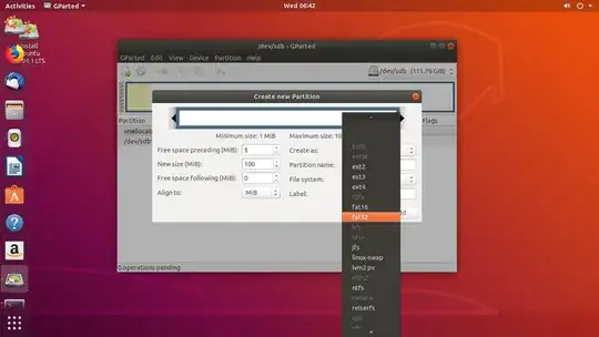

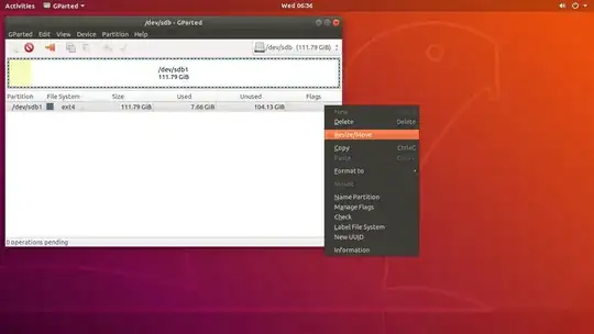

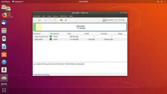

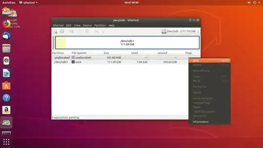

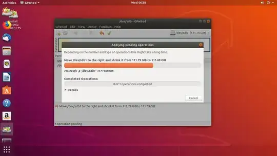

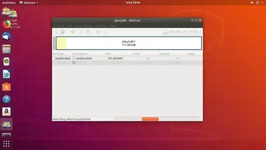

As we are going to format sda. We need to create EFI System Partition on sdb. sdb has only one partition sdb1. We have to create a EFI partition at start of the disk.

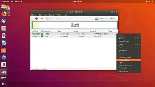

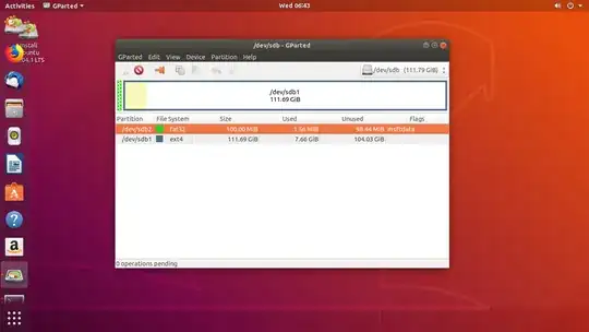

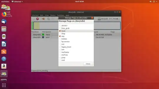

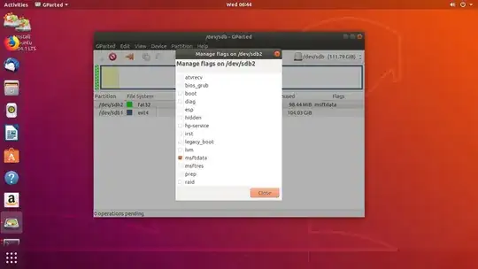

Now we got unallocated space of 100mb at start of disk sdb. In order to install grub on this we need it in FAT32 format with boot and esp flags.
Here if you observe, we have created 100mb EFI partition at the start of the disk. which should be named as sdb1. but gparted still shows it as sdb2. to sort out this
run sudo sgdisk -s /dev/sdb

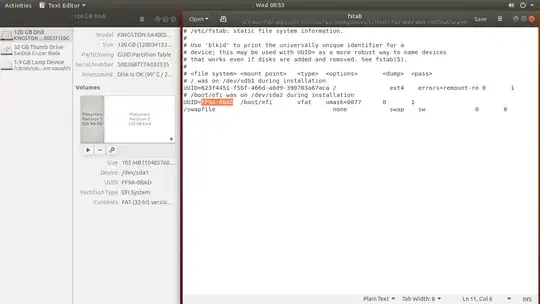

Now we need to know the UUID of freshly created EFI Partition (sdb1) on device sdb.
Open "Disks" app.
Copy the UUID of sdb1.
Open the fstab file.
sudo nano /mnt/etc/fstab. (note: i have used gedit, attached pics are gedit in the below).
paste the UUID at the rite place.
Save and Close.

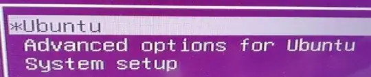

Now reboot.
