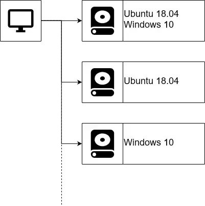

NVMe0 - New Ubuntu 18.04 (works) [1]
      - New windows 10 (works) [2]
SSD0  - Ubuntu 18.04 (old) [3]
SSD1  - Windows 10 (old) [4]

Here is a Sketch
a sketch of the disk/OS layout
