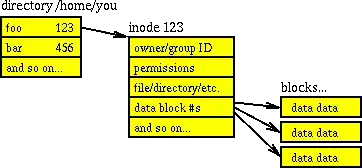

Directory and inode pairing is also explained in How are directory structures stored in UNIX filesystem?. a directory itself is a data structure, more specifically: a list of objects (files and inode numbers) pointing to lists about those objects (permissions, type, owner, size, etc.). So each directory contains its own inode number, and then filenames and their inode numbers. Most famous is the inode #2 which is / directory. (Note, though that /dev and /run are virtual filesystems, so since they are root folders for their filesystem, they will have the inode number apropriate for the root in their respective filesystems; i.e. an inode is unique on its own fileystem, but with multiple filesystems attached, you have non-unique inodes ). the diagram borrowed from the linked question probably explains it more succinctly:
Directory-iNode-Block

Data itself may be unique, but inode numbers aren't unique. If we have a hard link to foo called foobar, that will point to inode 123 as well. This inode itself contains information as to what actual blocks of disk space are occupied by that inode. And that's technically how you can have . being linked to the directory filename. Well,almost: you can't create hardlinks to directories on Linux yourself, but filesystems can allow hard links to directories in a very disciplined way, which makes a constraint of having only . and .. as hard links.
