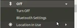

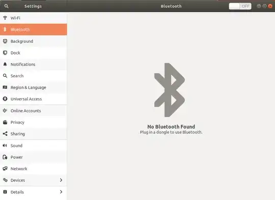

I have an issue where my bluetooth randomly cuts out, like so:
Screenshot_Of_Settings_Menu
