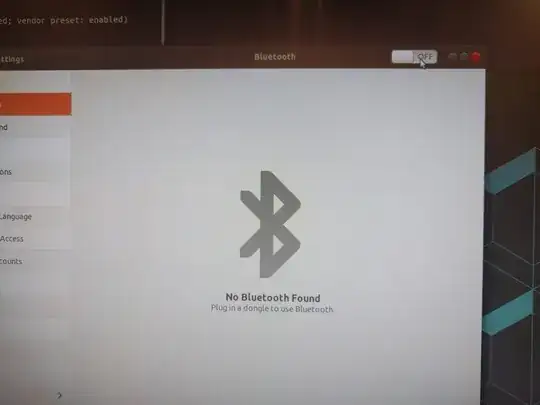

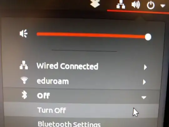

First off, I have checked a bunch of other threads on here, and none of them have a solution. I had Bluetooth working two weeks ago, wasn't using it for a couple of days, and now it's not working at all (images from system settings attached).
no bt foundenter image description here
It shows it is working from the command line after following instructions from here, but the system settings still show no bluetooth, so I can't connect to anything.

I have all the latest updates, I have restarted the computer twice. How should I fix this?
