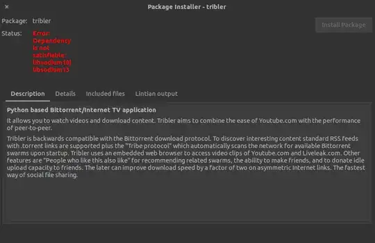

trying to install this https://www.tribler.org/ on Ubuntu 18.04 but I get this error:
And I can't find any repo for libsodium
tio@tio:~$ sudo apt install libsodium18
Reading package lists... Done
Building dependency tree
Package libsodium18 is not available, but is referred to by another package.
This may mean that the package is missing, has been obsoleted, or
is only available from another source
E: Package 'libsodium18' has no installation candidate
tio@tio:~$ sudo apt install libsodium13
Package libsodium13 is not available, but is referred to by another package.
E: Package 'libsodium13' has no installation candidate
tio@tio:~$

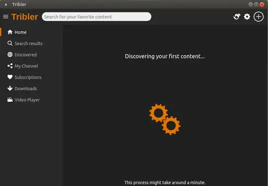

Just tested pre-release version. It works out the box:
wget https://github.com/Tribler/tribler/releases/download/v7.1.0-rc1/tribler_7.1.0-rc1_all.deb
sudo apt-get install ./tribler_7.1.0-rc1_all.deb
and launch it:
Tribler on Ubuntu 18.04 LTS MATE

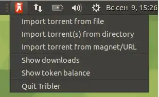

it has fully-functional tray icon with drop-down menu (at least on MATE):
Tribler on Ubuntu 18.04 LTS MATE - tray icon
Notes: currently bug 3864 is fixed, and fix will be included in next stable version.
