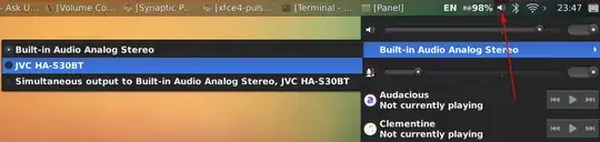

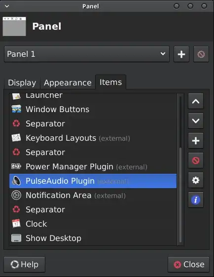

Testing Xfce panel version 4.12.2: the volume indicator already has that feature. It is a pulseaudio plugin (xfce4-pulseaudio-plugin) for the Xfce panel.
The output device is listed under the main scroll given more than one sink is available; on mouse hover a list of available output devices is displayed.
So, no external application is needed for the purpose discussed here, although pavucontrol may be useful (especially given that Xfce has no specific audio settings like other desktops have).

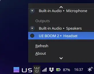

Non-Xfce-specific tools can be also used like pasystray(PulseAudio System Tray), as explained here, similar to Sound Switcher Indicator, already mentioned under this question; pasystraydoesn't need a new PPA to be added.
