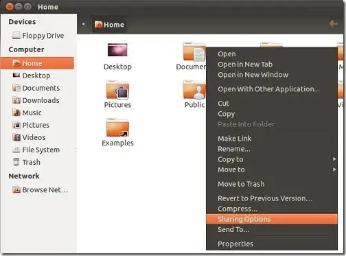

To get started, right-click on the folder you wish to share and select ‘Sharing Options’
screenshot

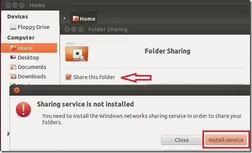

When prompted to install Samba services, do it.
screenshot

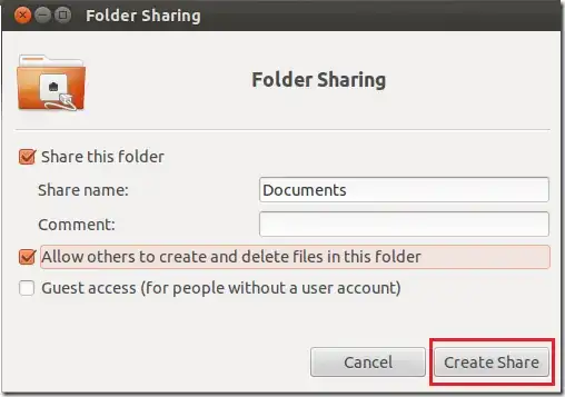

Then click ‘Create Share’ to complete the process.
screenshot

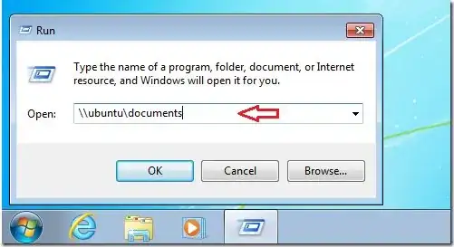

On the Windows machine, go to Start –> All Programs –> Accessories –> run and type the command:
\\computer_name\share_name
computer name can be ip address of ubuntu machine , to check ip of ubuntu machine , go to ubuntu machine & open terminal & type ifconfig
screenshot

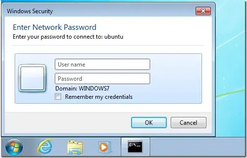

Type the Ubuntu computer name and the share name of the resource.
You will get a prompted to enter your credentials. Type your Ubuntu username and password and click ‘OK’
screenshot

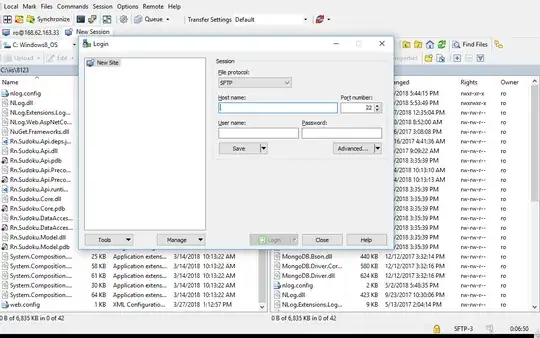

after installing go to windows machine & download / install FileZilla & open it
screenshot
  • Host = Ubuntu Machine Ip address
  • Username = Your Ubuntu Machine Username
  • Password = You Username Password
  • Port = 22

There is a free file manager with GUI WinSCP. You can copy files in one click.
After creating connection you have one panel with your local computer and a panel with a remote computer.
