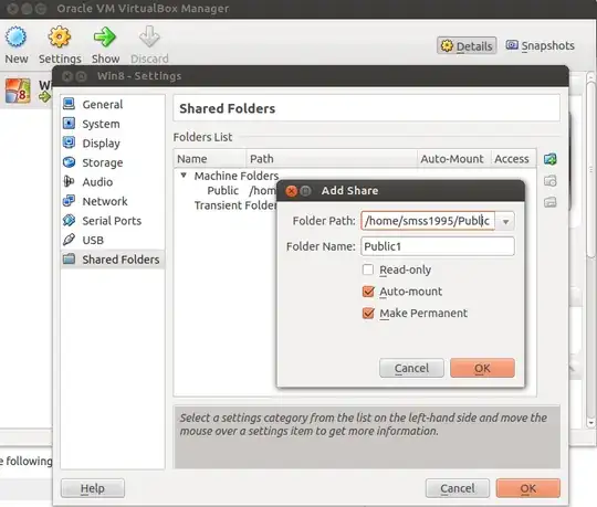

  1. Go to the VirtualBox and VirtualMachine settings and click on "Shared Folders" Tab, Then Click on the "Add folder" and select your desired path (as depict below), If you want write permission on virtual machine, do NOT mark first check mark.
VirtualBox Shared Folders Setting
Then click on "OK". and start your virtual machine.

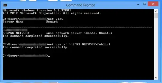

In Computer2 (VirtualBox -> Windows):
Open a new CMD and execute the following:

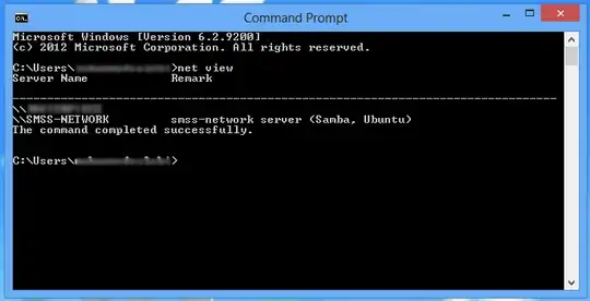

net view
You will be able to see Computer1 (Ubuntu / Linux) as depict below
net view in cmd
Then, you can use the following command in CMD to using Network Space as a Drive on Windows :-)
net use x: \\SMSS-NETWORK\Public1
net use in cmd

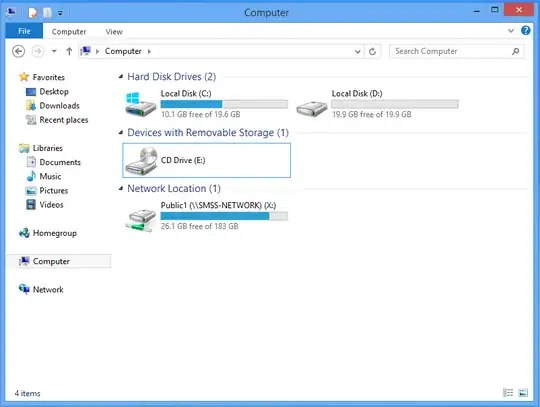

Then, in your MyComputer window you will see X: drive as depict below:
MyComputer window
You can remove it by right click on it and select "Disconnect" option.
