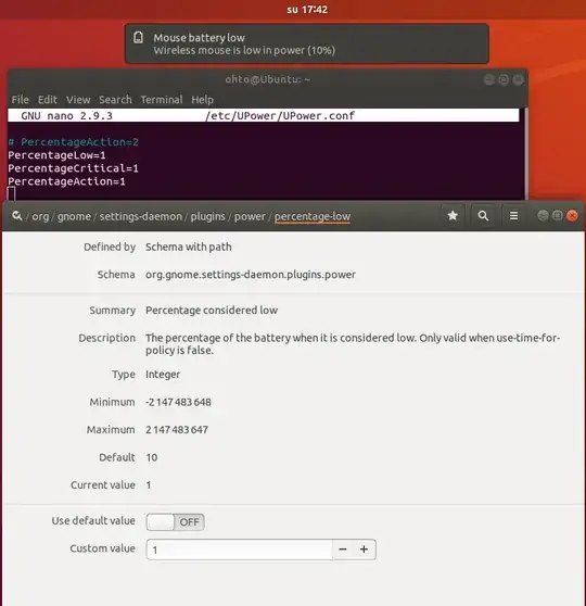

Notification blocks for example tabs from browser and is very annoying overall. Mouse works fine and will most likely continue working over a month, and battery is really simple to swap. Therefore there is no good reason to keep that notification appearing constantly and a good reason to disable it.
I have tried this answer, no help.
I also tried disable all notifications, no help.
I tried command gconftool --set /apps/gnome-power-manager/notify/low_capacity --type boolean false, no help
I have booted after changing these settings.
