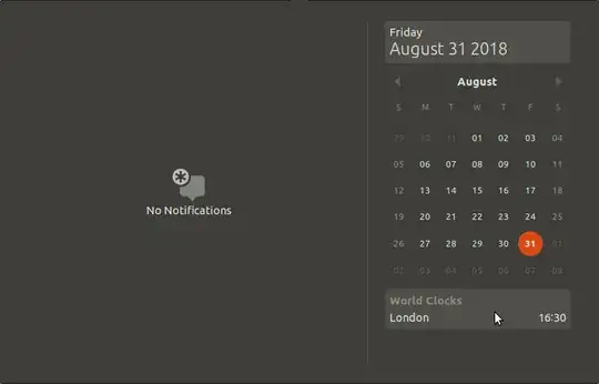

GNOME Clocks should work fine if it's set up correctly. However, if you have installed the application from the (GNOME) Software application, there is a chance that you have installed the snap version of Clocks. You can verify that by running snap list and checking whether the output contains gnome-clocks.
If that is the case, this behaviour is not very surprising given the security restrictions of snap packages. To fix this remove the snap application by running
snap remove gnome-clocks
and install the traditional one by running
sudo apt install gnome-clocks
Then you should be able to find added time zones in the date & time dropdown tray (N.B. You may have to log out and back in).

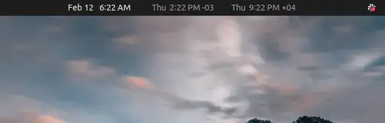

@pomsky answer (replacing snap package with apt package) works for me as well. In addition, I also like to use gnome extension panel-world-clock-lite to make it always visible on the task bar:
EDIT:
To install it:
  1. Install Gnome Clocks and Gnome Tweak Tool
    sudo apt-add-repository universe
    sudo apt install gnome-tweak-tool
  2. Install panel-world-clock-lite
  3. Open Gnome Clocks and add timezones to be shown
  4. Open Gnome Tweak and enable "Panel World Clock" extension
  5. Reboot your computer
