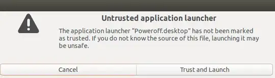

After moving a .desktop file into the "Desktop" location ~/Desktop, it show the icon on the Desktop. For the first run you have to trust the application. Is there any way to trust it directly without clicking? chmod +x *.Desktop is already done to make the file executable
