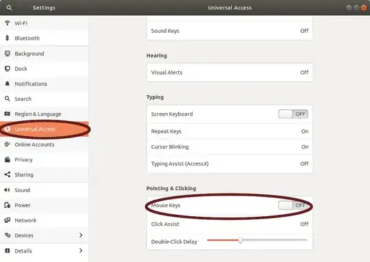

Problem solved.
  1. Click on triangle top right corner
  2. Click on the icon wrench
  3. Click in the left column on Universal Access
  4. Go to the bottom of the page deactivate mouse keys (it is the first line in the box)

After looking around the Menu I found the answer as follows:
Preference >accessibility > Mouse: "Control the Pointer using keypad" Turn it OFF!
Ubuntu 18.04:
Srttings > universal Access > pointing and clicking: "Mouse keys" Turn it OFF!
