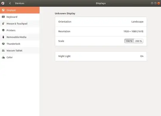

As the title suggests, I am experiencing issues with my Display in Ubuntu 18.04. I have seen somewhat related posts (like this one), but those typically suggest they have several detected displays, where one of them is dubbed 'Unknown Display'.
Well, I only have a single display called 'Unknown Display', which means I:
  • cannot add a second/third/etc screen,
  • cannot adjust the resolution,
  • and cannot adjust the brightness
I would very much like to be able to do the above, obviously, and I was hoping somebody over here might be able to help me out. I have tried out several things, like removing the current drivers in favor of older ones, but I seem to be missing something crucial every time..

Here is a screenshot of the 'Settings -> Devices -> Displays' window in my Ubuntu by the way: display-settings

I had this problem and removing the monitors.xml config didn't work.
there was a problem w/ the nvidia driver. check to see by running
ubuntu-drivers devices
and if that looks good
sudo ubuntu-drivers autoinstall
should do the trick
