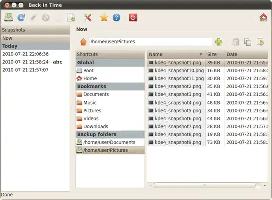

Try backintime-gnome Install backintime-gnome.
BITSCRNSHOT
It is a a good program for making backups of individual folders or entire drives.
The project's site is here: http://backintime.le-web.org/
