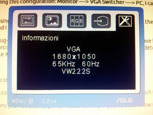

If I disconnect the monitor for a minute and I attach it through the VGA Switcher, the resolution is perfect and the monitor is correctly set to 1680x1050 @ 60Hz
Look at this screenshot:
This means it is working nice. What's the problem then? The problem is that if I reboot Ubuntu using the generated xorg.conf I've pasted before the fonts are all displayed ugly and the images are blurred. The resolution of the screen is 1680x1050, but the monitor is using another resolution an I suppose it's enlarging the screen image.
I'll post another picture later in update #2 so you can see with your eyes.
=== UPDATE #2 ===
I've rebooted Ubuntu using the configuration I posted and... it works! Probably the previous time I generated it I didn't specify the 60 Hz in the nvidia-settings tool and that value was not saved. For now it's working. Now I can't wait to have also my XBox VGA cable ;)
