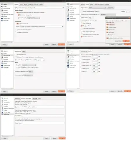

I also attach screenshots of my SMPlayer's options:
Full size
