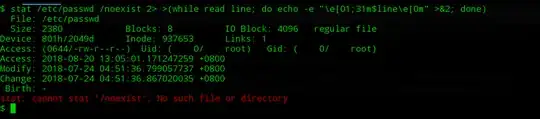

Another way, if you want to visually separate them is to colorize the output. Based on Balazs Pozar's answer, you could do:
command 2> >(while read line; do echo -e "\e[01;31m$line\e[0m" >&2; done)
