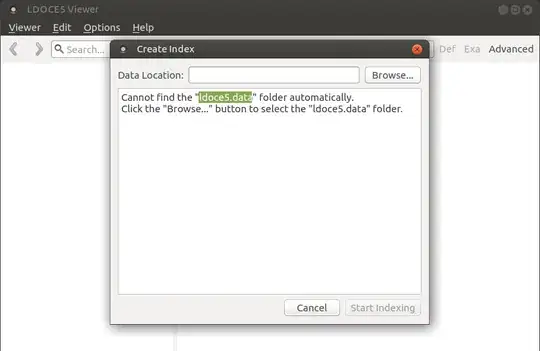

I inspired these commands from the software's source repository on GitHub. Now with Ubuntu 18.04 I face with some errors. I realized from this link that I should install another version of LDOCE5 Viewer which is based on pyqt5:
This viewer of LDOCE5 no longer works as expected. It's been a while since the upstream has been updated. Installing this PKGBUILD is NOT recommended! Consider using another version of LDOCE5 Viewer ( https://github.com/purboo/ldoce5viewer-pyqt5 is strongly recommended ) or an entirely different dictionary (e.g.: GoldenDict)
I could not find any instructions for installing the new LDOCE5 Viewer. How to install this software on Ubuntu?

Here is the commands and their outputs as per the answer.
opt@pc:~$ cd ~/Downloads
opt@pc:~/Downloads$ sudo apt-get install git make python pyqt5-dev-tools python3-pyqt5 \
> python3-pyqt5.qtwebkit python3-lxml python3-whoosh  qtgstreamer-plugins-qt5
[sudo] password for opt:
Reading package lists... Done
Building dependency tree
make is already the newest version (4.1-9.1ubuntu1).
python is already the newest version (2.7.15~rc1-1).
python set to manually installed.
python3-lxml is already the newest version (4.2.1-1).
pyqt5-dev-tools is already the newest version (5.10.1+dfsg-1ubuntu2).
python3-pyqt5 is already the newest version (5.10.1+dfsg-1ubuntu2).
python3-pyqt5.qtwebkit is already the newest version (5.10.1+dfsg-1ubuntu2).
python3-whoosh is already the newest version (2.7.4+git6-g9134ad92-1).
qtgstreamer-plugins-qt5 is already the newest version (1.2.0-5).
git is already the newest version (1:2.17.1-1ubuntu0.1).
0 upgraded, 0 newly installed, 0 to remove and 0 not upgraded.
opt@pc:~/Downloads$ git clone https://github.com/purboo/ldoce5viewer-pyqt5.git
Cloning into 'ldoce5viewer-pyqt5'...
remote: Counting objects: 625, done.
remote: Total 625 (delta 0), reused 0 (delta 0), pack-reused 625
Receiving objects: 100% (625/625), 1.22 MiB | 1.66 MiB/s, done.
Resolving deltas: 100% (216/216), done.
opt@pc:~/Downloads$ cd ldoce5viewer-pyqt5
opt@pc:~/Downloads/ldoce5viewer-pyqt5$ make
