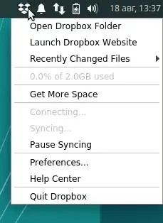

On clean installation of Xubuntu 18.04.1 LTS I started with
sudo apt-get install thunar-dropbox-plugin
then rebooted, logged in and waited for proprietary DropBox installer to finish, then logged in to my DropBox account. Then got icon in place, but left and right clicks did not work.
To fix it we need to change dropbox start -i to dbus-launch dropbox start -i.
I recommend to make it with script:
rm ~/.config/autostart/dropbox.desktop
dropbox autostart y
sed -i "s/dropbox start -i/dbus-launch dropbox start -i/" ~/.config/autostart/dropbox.desktop
Then logout and login back and enjoy:
Dropbox on Xubuntu
Note: if this method does not work for you try to remove dropbox completely with
dropbox stop
rm -rf ~/.dropbox ~/.dropbox-dist
sudo apt-get purge thunar-dropbox-plugin
sudo apt-get autoremove
then reboot and start from the beginning.
