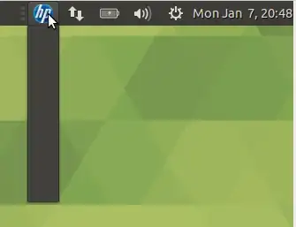

Then I after reboot I have hp-systray in the tray (indicator applet), but its dropdown menu is not functioning:
hp-systray not showing dropdown menu
How can I fix this behavior?

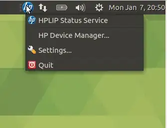

and then reboot and enjoy:
hp-systray with dropdown menu
Notes:
This method is useful for 18.04 LTS, 18.10, 19.04 and 19.10. It is a temporary fix for bug 1810745.
