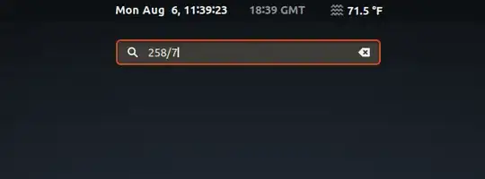

On prior versions of Ubuntu GNOME, I could type basic expressions into the gnome search bar and get the answer. Ever since I upgraded to Ubuntu 18.04 however, I cannot; it shows no results.
No results
I've already found this answer but GNOME Calculator is already installed on my machine and still no luck. Any ideas?
