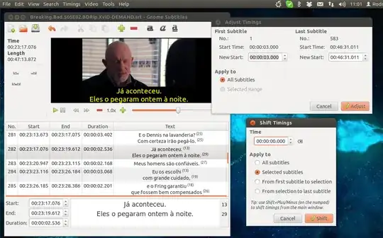

I'm surprised no one mentioned this:
gnome-subtitles Install gnome-subtitles
It has impressive features, it's extremely easy to use and very well-polished. A lot of care and detail in its UI (check the char count in each line).
I use it all the time to shift subtitle timings to/from HDTV to BDRip/DVDRip releases.
gnome-suttitles
Side-note: VLC player has on-the-fly subtitle timing shift. It will not change your .srt file, only the playback, but it's very convenient for movies you'll only watch once and don't care about saving the adjustments. I assign them to UP and DOWN directional keys.
Extra info (which was hard to figure out): To shift multiple subtitles back or forward together, select the subtitles and use the menu option Timings > Adjust. Now you can adjust the timing of the first and last subtitles you've selected, and all the selected subtitles will get shifted by the number of seconds you choose.

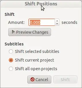

With Gaupol you can edit the subtitles. Select the text you want to adjust, then go to "Tools" > "Shift Positions" and change as you like.

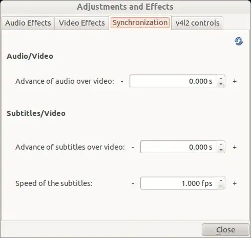

Although it does not make a "permanent change", with VLC you can do that with the movie you are seeing. Just go to "Tools" > "Track Synchronization".

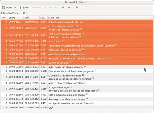

For me the best option is subtitleeditor ( click on the link for instruction on how to use it )
It let you change frame rate in the subtitles and scaling Subtitles size ( useful for progressive desynchronization )
Install:
sudo apt-get install subtitleeditor
