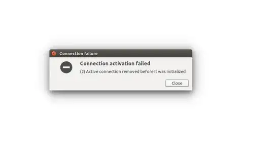

sudo service network-manager restart doesnt work
shows this after I try reconnecting
requires reboot required after drop
