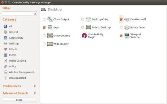

I had the same problem and this reference worked for me. You have to install ccsm (compizconfig-settings-manager) tool:
sudo apt install compizconfig-settings-manager compiz-plugins-extra
open it:
ccsm
and you have to click the Desktop Wall option under the Desktop tab on the left panel.
See this image
I hope it helps you too.
