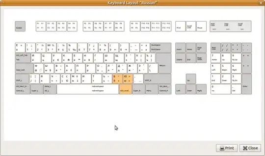

    3. Back to Text Entry section, select Russian keyboard layout and click small keyboard icon keyboard icon to ensure that we have guillemets («елочки»):
      Guillemets or Елочки in GNOME
    4. Close Keyboard windows.
  3. Use guillemets («елочки») in any application by pressing RightAlt with corresponding keys (Б and Ю; , and .).

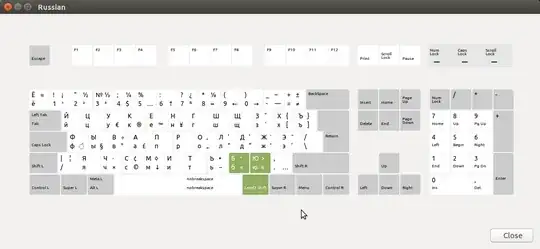

    2. In Key to choose 3rd level choose needed key (for example Right Alt)
    3. In Miscellaneous compatibility options check Enable extra typographic characters
    4. Click Close
  3. Select Russian keyboard layout and click Show to ensure that we have guillemets («елочки»):
    Guillemets or Елочки in MATE
  4. Use guillemets («елочки») in any application by pressing RightAlt with corresponding keys (Б and Ю; , and .).
