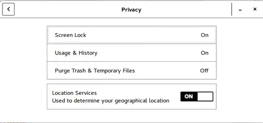

The quick workaround is use capital -O (One shot manual mode) instead of small one -o (One shot mode) i.e:
redshift -O 6500
GeoClue is the Geolocation service which needs the location service enabled. So make sure that Location service is enabled from Settings > Privacy:
